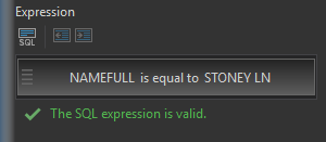

I have found a frustrating quirk in the Unique Value search in the SQL Expression related to the Select Layer by Attribute tool, ArcGIS Pro v2.2.3.  You have to know the letter case (upper or lower case) of what you are searching for otherwise no results.  This was not an issue in ArcMap, letter case did not matter for results.  I don’t always know the case the attributes were entered with, especially in unfamiliar data sets.  This needs to be addressed.
Ex)   Lower case v = no results                                            Upper case V = results
 VS

When you say that letter case didn't matter for results in ArcMap, can you give an example?
I tested in ArcMap and here is what I see:
When I use lowercase, no attributes are found.  When I use all uppercase, which is how the attribute is stored, the expression works.  So case does matter in the expression.
I'm just wondering how we can compare the two since ArcMap doesn't use intellisense and Pro does.
In Pro, it looks like we see the same behavior:
Because it's just a SQL expression and case does matter.
So if you can point out where in ArcMap letter case doesn't matter, that could be helpful here.  But I think it is clear the intellisense in Pro might be improved if it weren't case sensitive.

So I am referring to the “Get Unique Values” search on a string field.  Here is my process in ArcMap:
FENAME = Click the “Get Unique Values” and in “Go To” type a lower case r.  That result takes me to the r section of my attributes.  The case (upper or lower) does not matter here.  See below that closing out the Selection window and starting fresh, but instead typing an upper case R yields the same results taking me to the same section of my attributes list.
ArcMap lower case:
ArcMap upper case:
So this is my issue with ArcGIS Pro, attempting a similar “Unique Value” search as I had shown at the beginning of the post gives no results if you do not know the letter case of the string you are searching for.  I understand that it has to be the correct case in the SQL expression in order to yield any results and if I was able to find the attribute through the “Unique Value” search I would and add that correct case attribute value to my expression.
I hope this explanation helps.  Additionally I have been screen sharing with tech support to show them what I was talking about.
