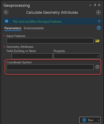

In ArcGIS Pro, the Calculate Geometry Attributes geoprocessing tool allows users to do just this!  By selecting the coordinate system you would like to project into (in red below), users are able to define new fields with calculated XY coordinates in any Coordinate System.
For further information about the  Calculate Geometry Attributes tool, refer to the doc linked below:
