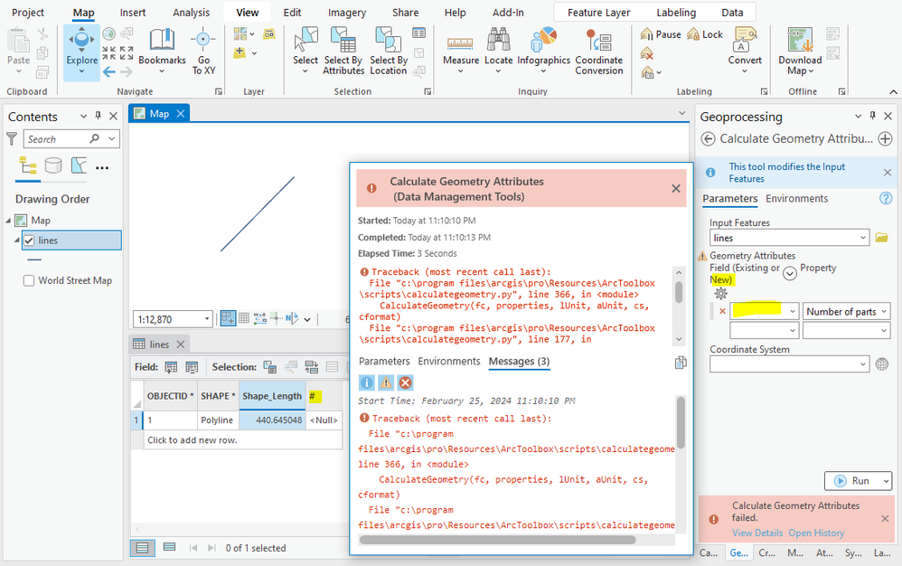

When I use Calculate Geometry Attributes to create a new field, I get an error if the field name is left blank. A temporary field called "#" is created but not populated.
File "c:\program files\arcgis\pro\Resources\ArcToolbox\scripts\calculategeometry.py", line 366, in <module>
CalculateGeometry(fc, properties, lUnit, aUnit, cs, cformat)
File "c:\program files\arcgis\pro\Resources\ArcToolbox\scripts\calculategeometry.py", line 177, in CalculateGeometry
fidxes = [ucur.fields.index(cprop[0]) for cprop in properties]
File "c:\program files\arcgis\pro\Resources\ArcToolbox\scripts\calculategeometry.py", line 177, in <listcomp>
RuntimeError: Cannot find field '#'
I suppose an error of some sort might be expected. It seems like the tool was expecting the new field name parameter to be entered by the user.
But I think it would be better if the tool could automatically generate field names if the field name parameter is left blank. To save the user from manually typing in a field name for multiple fields. It would also have the benefit of creating standardized field names.
