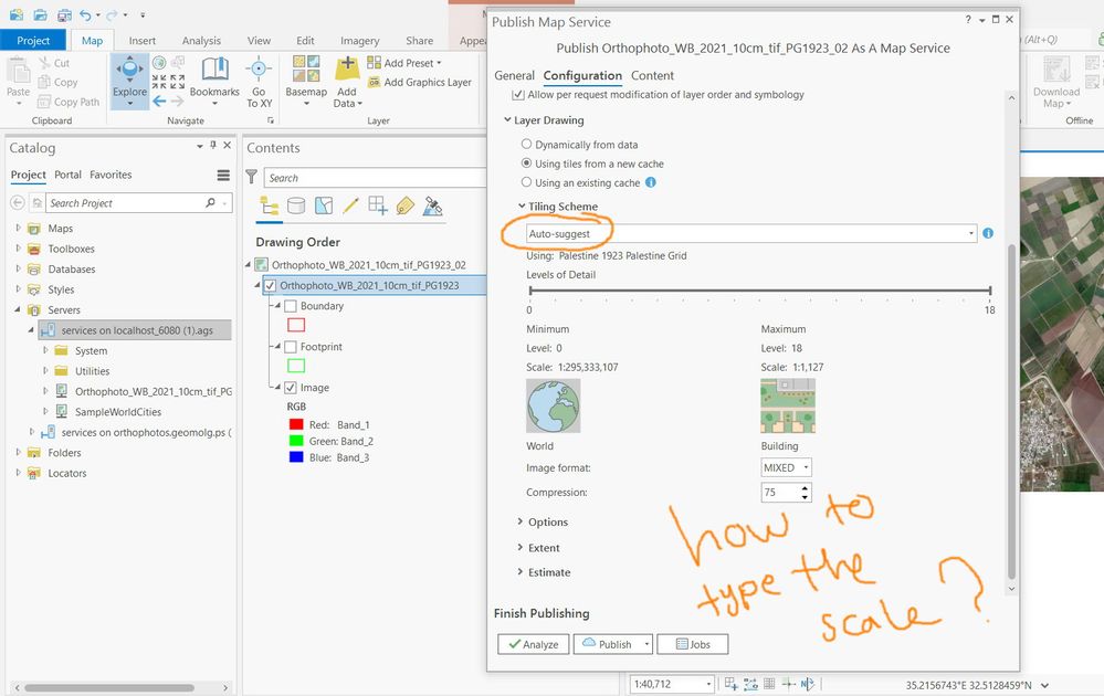

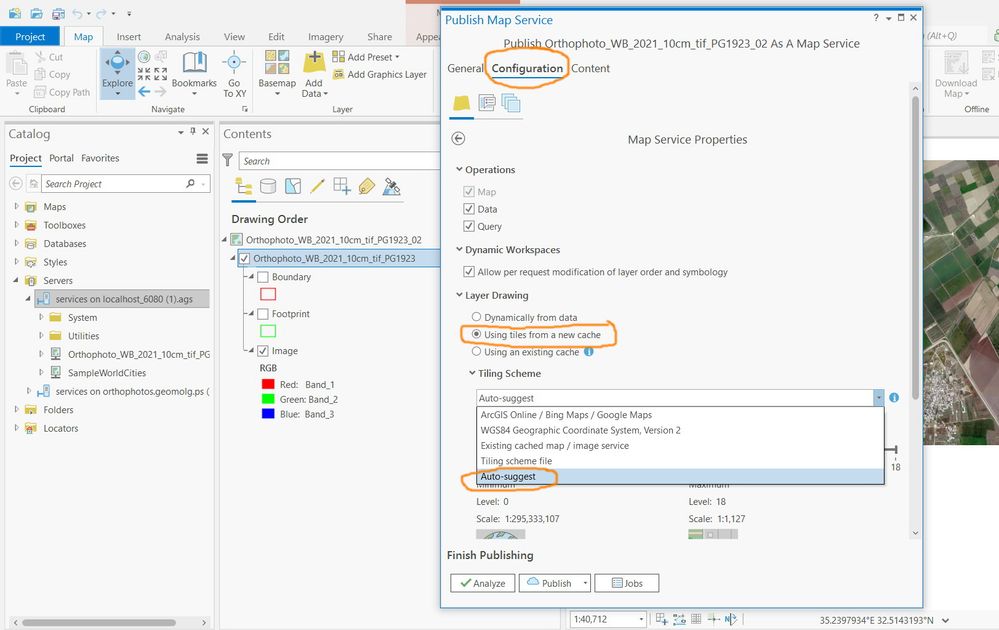

Caching “Suggestion” option is not available in ArcGIS Pro 2.4.1,
It would be great if the caching “Suggestion” option gets available in ArcGIS Pro

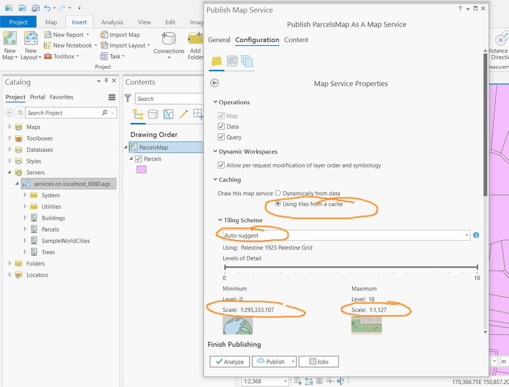

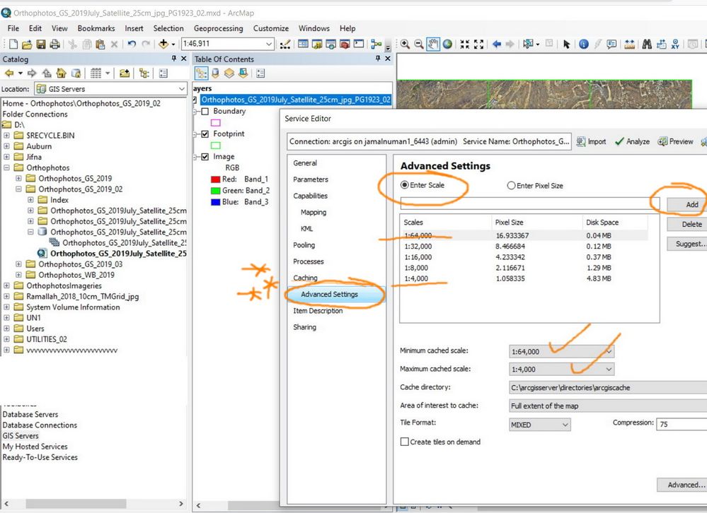

Not really. The “advanced settings” available in ArcMap is not there in Pro. How scales can be entered as we do in ArcMap?

I've almost left ArcMap, but this is one thing that I still need ArcMap for. To be able to create my own custom tiling scheme. The auto suggest option is implemented in Pro, but without the advanced settings where you can modify the scales it's kind of useless to me.
@KoryKramercould you change status to partly implemented or something? or would it be better to create a new idea for the part where you can type your own scales? I looked for one but didn't find anything.

Hi, it is possible to cache using custom scales. This can be accomplished by using the Generate Map Server Cache Tiling Scheme tool to create a custom tiling scheme that is then imported into the Sharing pane using the Tiling scheme file option in the dropdown.
@MattiasEkström If the above workaround doesn't meet your needs, I agree that this would be better as a new idea. Thanks!
