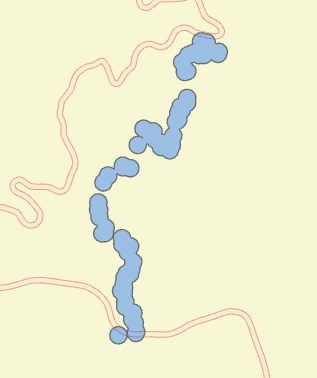

Thank you for asking, I could have added more images to be clearer.

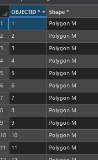

I need each polygon as its own record (like below).

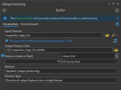

But the only options are dissolving all polygons into one record or leaving individual overlapping buffers (mine are points with 50-foot buffers).
My workflow is to create Buffers and Dissolve them into one record, then go to Edit | Explode to make them into multiple records. It would be nice to get the option inside the buffer tool.

After you get the buffer output as one feature, use Multipart To Singlepart tool to turn them into individual features.
