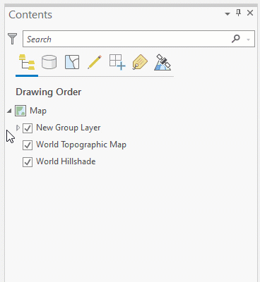

Here are my thoughts on this, copied from another post:
Please, if a group layer has a broken datasource in it, have the red Exclamation point show up at the group layer.
I know that that would get complicated because like, you'd be tempted to click it, but which layer are you actually repairing?
So don't let us repair at the group layer level. Grey out the box or something.
The reason why I'm asking for this is because we just moved all of our files and everything is broken, and it's misleading to look at this layer and be like "sweet, the data's solid here" and then you open it up aaaaand...
To clarify, I want this to go up to the very highest of groups, if we're doing nested groups. As long as a group layer has a broken data source in it, I want the entire group layer to show as broken.
In this example I darkened the exclamation point.
