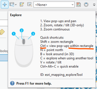

I agree with JakeK.  I would like to see Identify with the draw rectangle to identify all features in this area back.  It is really cumbersome making several layers selectable, selecting a rectangle of features, then opening each attribute table in turn and filtering to the selected features to see what is there.  Further, the lack of rectangular identify is going to be tricky for our novice users.
KoryKramer
@geodoozer for "rectangular identify" have you tried holding down Ctrl and drawing your rectangle with the Explore tool?

Thanks Kory!  That's helpful.
