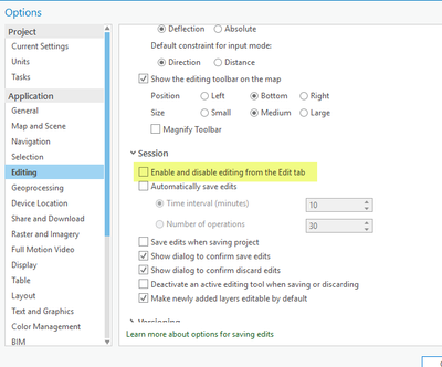

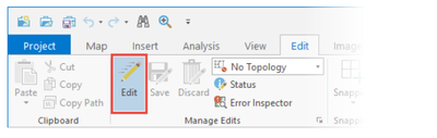

You can Enable / Disable editing from the editing options:
To get this:
Learn more here: https://pro.arcgis.com/en/pro-app/latest/help/editing/enable-and-disable-editing.htm

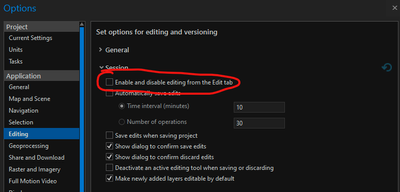

But how about an option to NOT save edits. I turned it on and when I turned it off it automatically kept the edits.
I have automatic saves turned off. I just made some edits and was prompted I needed to turn editing on in order to do it.  I made a geometry up date.  Save and Discard are greyed out.
So let me rephrase my idea. Make Editing behave exactly as it does in ArcMap.
