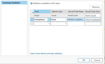

When you turn on feature clustering in ArcGIS Pro, the resultant clusters automatically have an ObjectID and a point count. There's a way to add additional fields to the cluster by right clicking on cluster in the contents pane and going to properties (see image):
Right now, unless the field you want to add is numerical, the only way you're allowed to join the fields is by "Mode". But if Pro starts allowing fields to be summarized by concatenating the values in a field, it would unlock all sorts of new possibilities. If you can label a cluster based on the names of features being clustered there, you could label clusters of facilities like the NPS does, dynamically.
