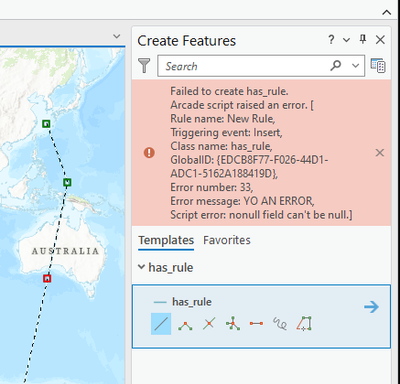

@Matt-Goodman We actually do retain the sketch when a constraint rule is violated:
Are you using ArcGIS Pro as the editing client? If so, which version? Any more details you can provide will help us get this Idea to the right team?
