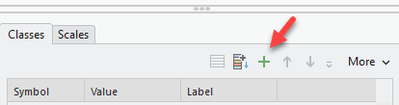

After your data is updated, you can go to symbology pane and click on the "Add unlisted values"(the green plus button):

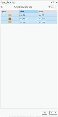

Then the pane will show the unlisted values due to data update, you can select all of them and click Ok:
Then those will be added to your map, and your other existing values and their symbols won't be impacted. Hope it helps.

Thank-you for your response.  This unfortunately doesn't work where you have Primary Symbology made up of Unique values from more than one field as it adds the new values, but doesn't give them the same symbology, they are multi-coloured, and then it also leaves the old values in the list, despite them having a count of zero.
