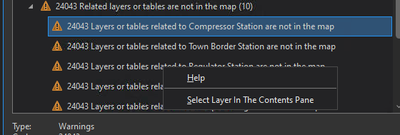

jmk_307
Doing some more work for adding the related tables and having to manually add each to the map, then re-analyzing because it is only showing the "show relates" contextual menu option on the first item in the list.
trying to view the second one below:
This gives ZERO indication of what relationship is missing.  Since it takes 6-7 minutes each time to analyze, this is painful.
