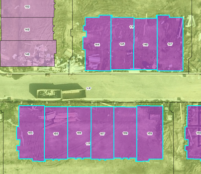

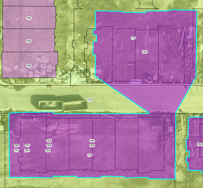

RichardFairhurst
As an illustration of a common workflow I do with the ArcMap Attribute Transfer Tool, I need to reshape building permits which were originally created as overlapping shapes based on the underlying common lot, because at the time of intake the condo parcels did not exist.  I need to resshape these permits to match the final condominium parcel.
In the picture below there are 10 overlapping permit shapes and each condo parcel overlaps a single common lot parcel within the same feature class.  Without the ArcMap dialogs, this task would be nearly impossible, but with them it is easy to match up the legal descriptions contained in the permits to the desired condo lots.
The final permit shapes.
The ArcMap Transfer Attribute Tool dialogs are the key to this entire workflow which results in a dramatic increase in the resolution of my permit data and greatly enhances my ability to understand the arrangement of the permits that can lead to better analysis results and opportunities.
