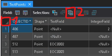

There is a "Select All" button, but it could be more obvious and user friendly.
Recognize Button 1? It's the same as in Excel, except for the annoying fact that you have to press Shift while clicking it to select all rows.
I guess they did it that way because it has a second mode: Ctrl clicking it will switch the selection.
So in my opinion, the Idea should be "Make this button Select All without keyboard modifier, and maybe give it a tooltip."
For completeness, Here are some ways to select all rows
  • Ctrl + A
  • Shift + Button 1
  • If no rows are selected yet, you can switch the selection
    • Button 2
    • Ctrl + U
    • Ctrl + Button 1
  • While it is very slow compared to the other options, you can also use Select By Attributes with a true statement like "1 = 1" or "ObjectID = ObjectID"
