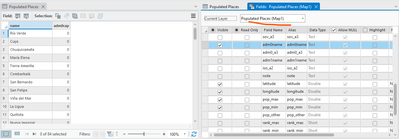

@ThomasHoman I followed what you're describing. Can you please confirm I am doing what you are?
I have two maps. Both have a layer from the same data source (in my case, Populated Places). I can set up my attribute tables differently for each map:
Note that when you go into Fields View, you have the option to work with the Data Source or the layer. So I set up the visibility on the Populated Places layer in Map.
I can then set up different field visibility for the Populated Places layer in Map1
Is that what you are trying to do?

That appears to be exactly what I am trying to do. I never paid any attention to that section of the fields view. Leave it to y'all to have already figured this out 😀
