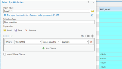

I just tried on a dev version and when I query Fire_Name is not equal to ZWINGE, I get all records except ZWINGE selected, including blanks and Nulls.
What you're seeing would be considered a bug rather than an idea, but we'll need to know your Pro version and it may be necessary to get the data and steps to reproduce in order to investigate.

Can you share the query you're using, both a screenshot of the query in the builder like I showed above as well as the resulting SQL?; e.g.

@KoryKramer, with standard SQL the following expression does not select NULL:
FIRE_NAME <> 'ZWINGE'
I just fired up Pro 3.0.2 and tested Select By Attributes on a feature class in a file geodatabase, and results were as expected, which is not to select NULL.
KoryKramer
You're correct @JoshuaBixby ! I think I got tripped up initially by user error - I would have had that column highlighted, so when I took a quick look, it appeared that Null values were selected. They were not. Thank you for the reality check!
And as you and Randy have both pointed out, this is all working as expected since = and <> don't work with NULL values.
