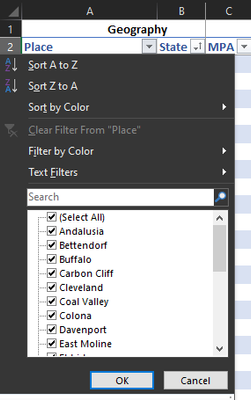

wayfaringrob
Or maybe a UI like this? This is what Excel can do when formatting as a table:
(Pro could incorporate SQL queries)

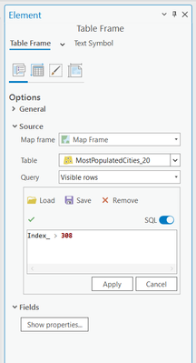

AubriOtis
This is available with SQL queries for table frames introduced in ArcGIS Pro 3.1
