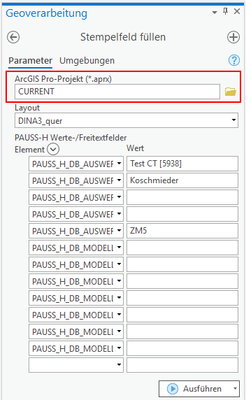

ChristophKoschmieder
Hello Hannes,
I am working on a number of projects where we provide additional functionality to ArcGIS by implementing geoprocessing tools with Python (which is always our first choice).
One use-case for the explicit parameter data type is the following:
  • For an AGP project (or "CURRENT", if executed in AGP for the project currently loaded)
  • determine the layouts, which exist in this project in order to
  • get the names and content of the text elements on this layout (as a value table)
The user can then modify the content of those text elements and by executing the GP tool the changes are written to the text elements in the layout.
