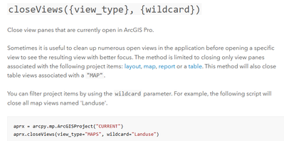

JeffBarrette
Status changed to: Implemented
This was implemented in ArcGIS Pro 3.7. An optional wildcard parameter was added to the ArcGISProject.closeViews method.
ArcGISProject | ArcGIS Pro documentation
