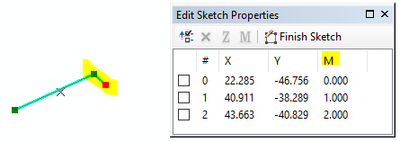

Before running script:

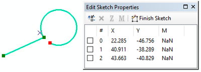

After running script:
