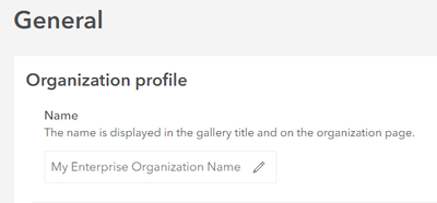

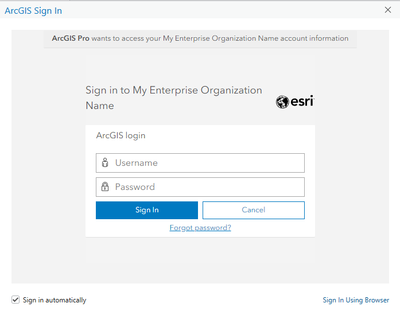

Have you tried setting your Enterprise organization name? Log into your portal website as an administrator, go to Organization > Settings > General > Edit the organization name.
When you sign in using Pro, the organization name will be displayed on the sign in dialog:
Does this help?

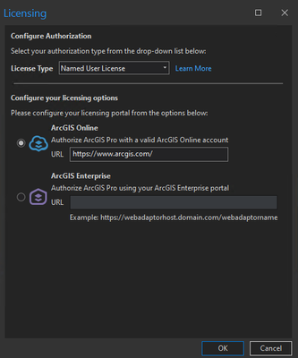

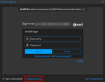

Apologies for the late reply. I'm seeing something different. When we go to sign in, it says it wants to access an ArcGIS Online account information. There are two options: "ArcGIS login" or "Your ArcGIS organization's URL". We have to click one of them to be prompted for a username and password. I tried the option to use the organization's URL to see what it would do and our AGOL organization name is shown in the pixelated spot in my screenshot below, but the top banner still says "ArcGIS Online" whereas yours also has the organization name in both places.
To log into ArcGIS Enterprise, we have to click the inconspicuous Configure Licensing link at the bottom of the window which I don't see in your screenshot. That link takes us to the window below. We use Active Directory so we are automatically logged in when we click OK. Our ArcGIS Enterprise organization name is set but it's never shown during the sign in process.
Your second screenshot shows is what I'd like to see. Was your software installed via the command line?
