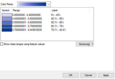

In ArcMap, there is no waiting. You can very quickly tab through a table and enter your values without waiting for something to load several times, likely because the user needs to hit OK/Cancel/Apply to commit, and edits happen instantly:
In Pro, the issue doesn't even go away if map drawing is paused. This idea is to reduce that wait time to be comparable with ArcMap, perhaps by disabling the auto-commit functionality.

1. The upper limit is "<=2.2,<=12.8,<=17.9,<=25.3,<=39", but "<=10,<=20,<=30,<=40, <=50", so manually rewrite from top to bottom.
2. If you rewrite "17.9" to "20", the symbol will be read, resulting in "<=10,<=17.9,<=20...".
3. If you change "17.9" to "20", you will lose one class.
I think that the problem will disappear if you click "Apply" like ArcMap.
wayfaringrob
@-_-  oh yeah, that is an issue! I run into that a lot and then since the # of classes once switched to manual is stuck/unchangeable, you're screwed. I didn't realize that that didn't happen in ArcMap but it makes sense.
