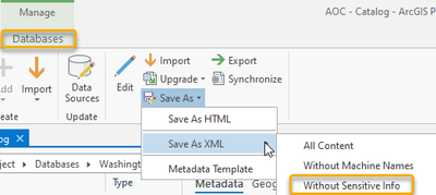

  4. View the metadata for the original feature class, then "save as XML" (don't be tempted to export) like this:  TimMinter_1-1607729272796.png
    I can't always reproduce the steps to get to that control.  Sometimes it appears, sometimes it doesn't.  Might be another idea...  anyway,
