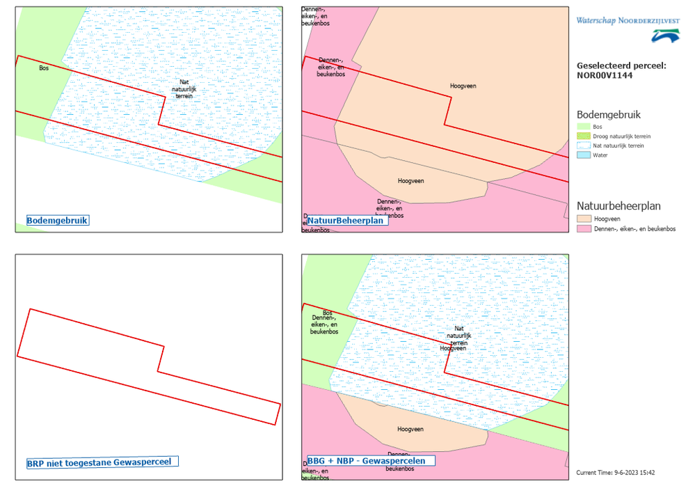

WaterschapNoorderzijlvest
I've used a workaround for this.
Create a map series on the first layout. Connect the following layouts to the fist.
Map series use as index the feature of interest in the first layout.
So updating the map series do update the other layouts too.
