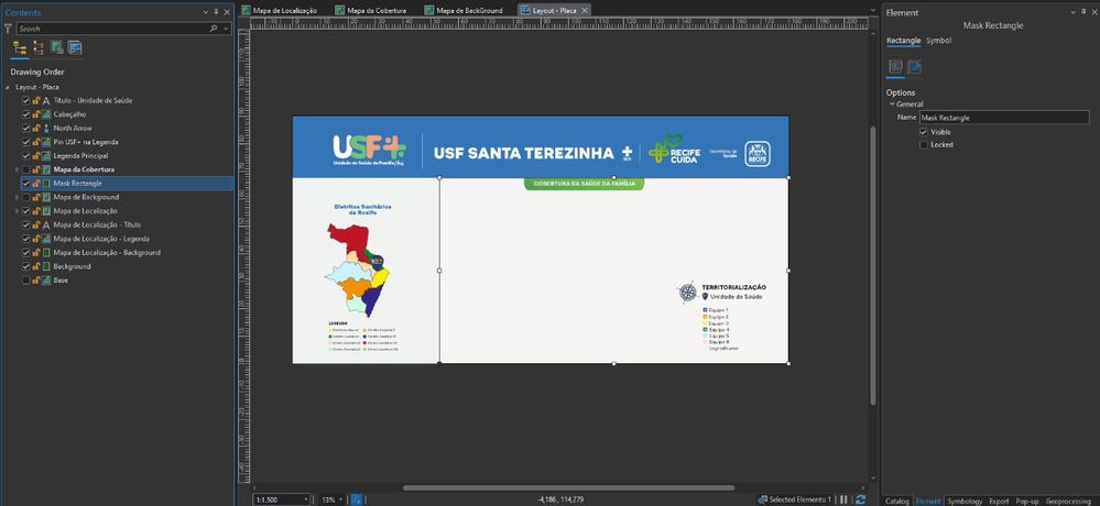

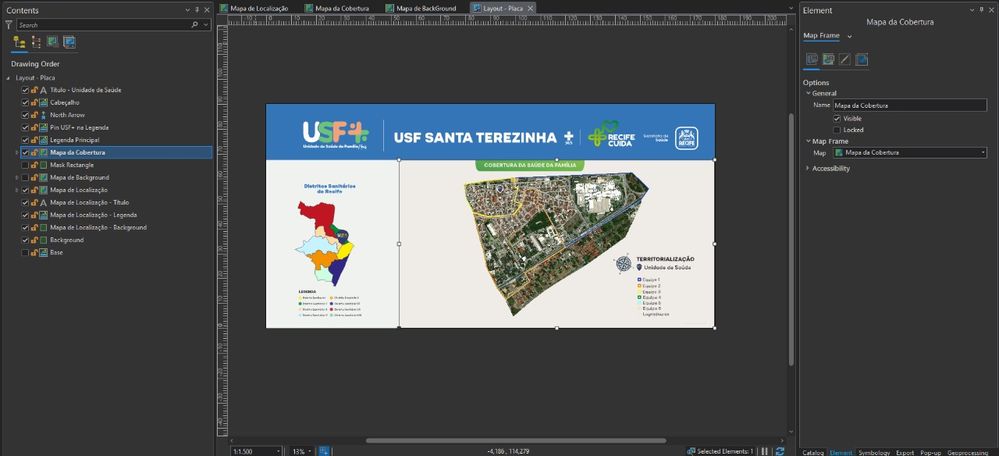

    • Ensure your surface layer (polygon or image) is well-configured with clearly defined borders. Use Map Series if necessary.WhatsApp Image 2024-06-27 at 11.19.49.jpeg

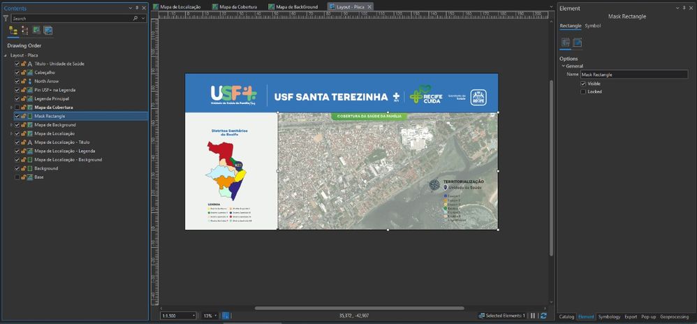

    • Insert a rectangular image with the desired color and transparency (50% recommended).WhatsApp Image 2024-06-27 at 11.19.49 (2).jpegWhatsApp Image 2024-06-27 at 11.19.49 (3).jpeg

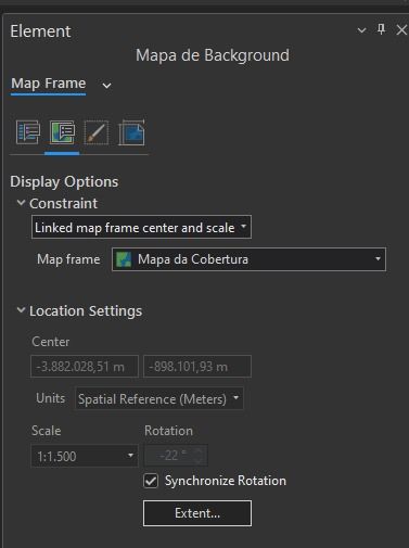

    • In the layout, set the Display Option to Linked map frame center and scale, referencing the main map.WhatsApp Image 2024-06-27 at 11.23.50.jpeg

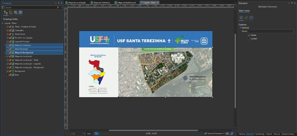

    • Insert the hybrid basemap and set it to Linked map frame center and scale, referencing the main map.
  5. Adjust Opacity:
    • Ensure the area around the main map has the desired opacity, creating the inverted polygon effect.

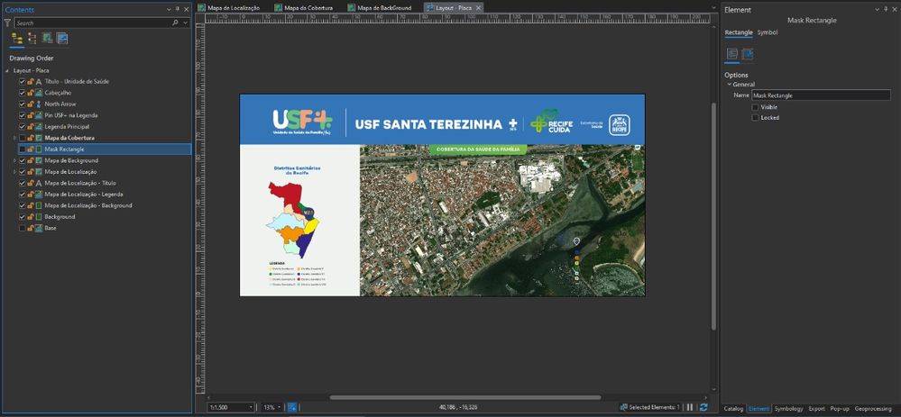

Final result
