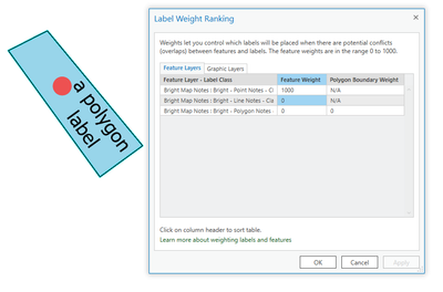

You can use feature weights for this.  Weight the feature class you don't want the labels to place over.  You can use a block of 1000

in the images below the red dot is a point feature class on top of the polygon feature class.  I'm labeling the polygon feature class and the label goes over the point feature.  if I give the point feature a weight of 1000 to block labels the polygon label shifts off of it

@WendyHarrison , I reopened this old project and confirmed that feature weights fixed the issue. No further action needed.
