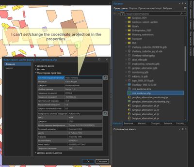

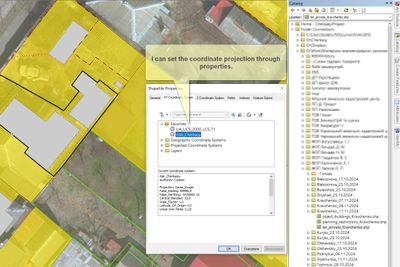

In the Catalog panel, through the Shape-file properties menu, set the selected coordinate projection, as it was implemented in ArcMap.
