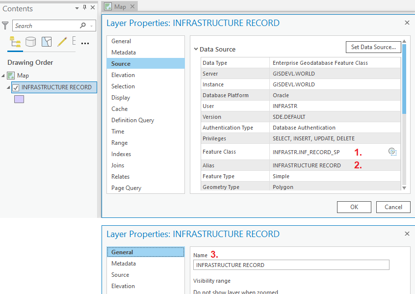

I prefer to reference the true table name of FCs/tables, not their alias. I find aliases cause confusion.
Could we have an optional setting in Pro (for all maps/projects) to use table names, not their aliases, as the default layer names in the Contents Pane?
In other words, use #1, not #2, as the default for #3:
