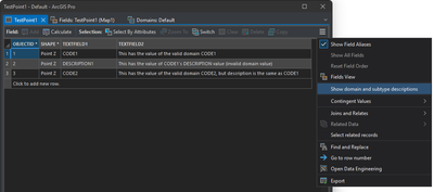

The point features NOT showing domain description values:

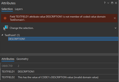

Point 2 selected - the Attributes pane correctly warns that the attribute value DESCRIPTION1 is not a valid domain value.

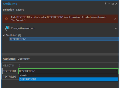

However, if you click the TEXTFIELD1 value pick list, and you select DESCRIPTION1, it will not update the base value to be the valid CODE1 domain value. It remains DESCRIPTION1. The only way to update the value to CODE1 is to flip the value to NULL (or some other domain value), and then choose the correct value; or, use Calculate Field and apply the CODE1 value that way.
And just to follow up on that side-note about CODE2 having the same description as CODE1 - there is no way to choose a value that resolves to CODE2.

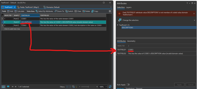

Further, there is an inexplicably odd behavior where if 'Show domain and subtype descriptions' is off, the Attributes pane shows TEXTFIELD1 as the CODE1 value! What in the heck? What kind of sense are beginner or even intermediate users supposed to make of this?

  3. (bug fix?) Fix the issue where a domain code description value entered as the base value shows up in the Attributes pane as the domain code value (when 'Show domain and subtype descriptions' is off). Is this a bug? Maybe fixed in other versions of Pro?

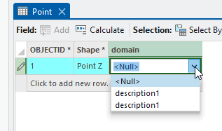

#1 only occurs when there are duplicate domain descriptions, which is a bug https://support.esri.com/en-us/bug/when-accessing-the-attribute-editor-via-the-edit-and-at-bug-00017...
#1 also only occurs for me in the Attributes Pane, not in the table:

#3 Is a bug, I agree, and could be related to #1 but I will definitely investigate.

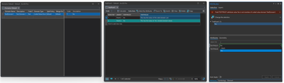

I will provide another example that is common: a domain with code 'Y' and a description of 'Yes':
If the base values of the field with that domain applied is 'Yes' rather than 'Y', the Attributes Pane will show an error that 'Yes' is not a member of the coded value domain, but the pick-list available to them shows 'Yes' and when they select it nothing changes, so the user likely will be confused about what the problem is, unless they are veteran of domain issues and goes to the attribute table and turns off 'Show domain and subtype description' values and diagnose any non-'Y' values from there.
The main "Idea" I'm proposing here could be something as simple as a warning that "your base value matches a domain description 'Yes', but is not the correct domain code value of 'Y'. Do you want to update this to match the valid domain code 'Y'?"
Maybe even further: "Do you want to update all values of 'Yes' in this table to the valid domain code of 'Y'?"
