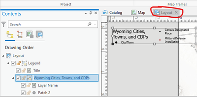

AlfredBaldenweck
That happens to me all the time.
I didn't precisely explain it earlier.
Specifically, make whatever selection you want in the table of contents, then click on the layout tab  to preserve the selection on the layout. Clicking directly on an item in the group on the layout will change the selection to be just that item, but clicking on the tab will maintain what you actually want, and you should be able to adjust with arrow keys after.
It is annoying, and I wish there were a key stroke to change back to layout or something, because clicking on the tab is not intuitive.
