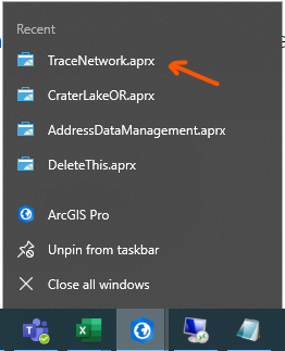

KoryKramer
Have you tried using the jump list?
You can get to the last closed project that way, and/or pin projects...
