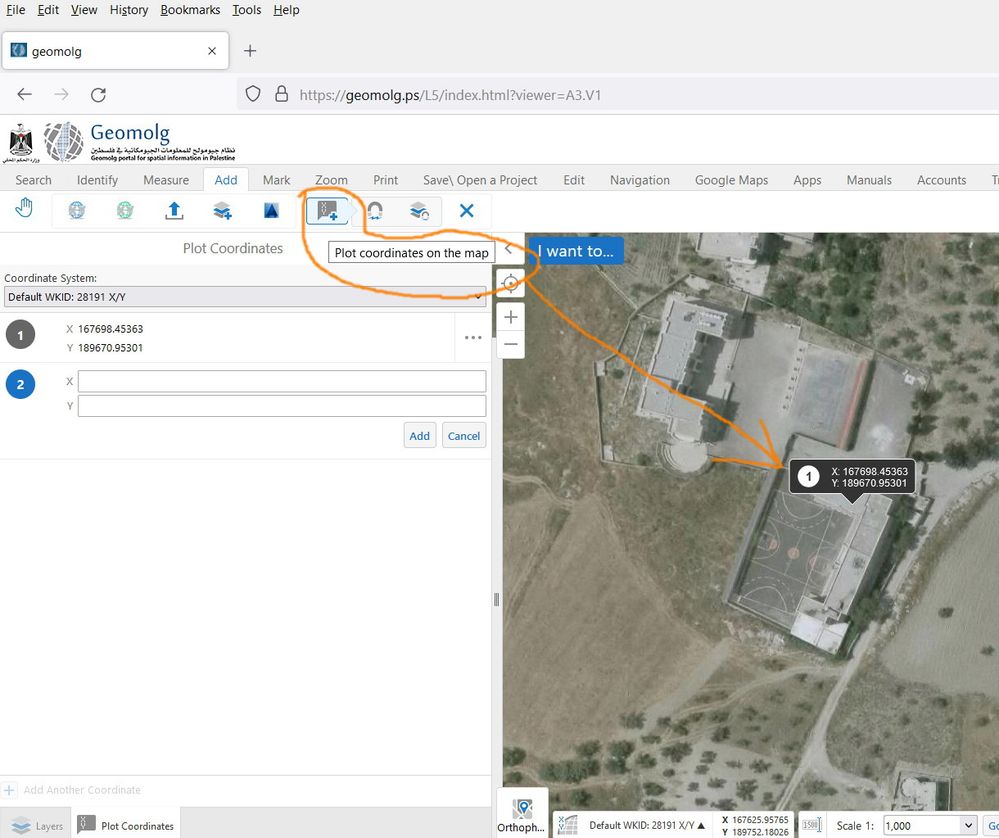

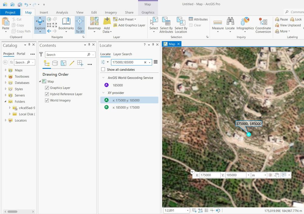

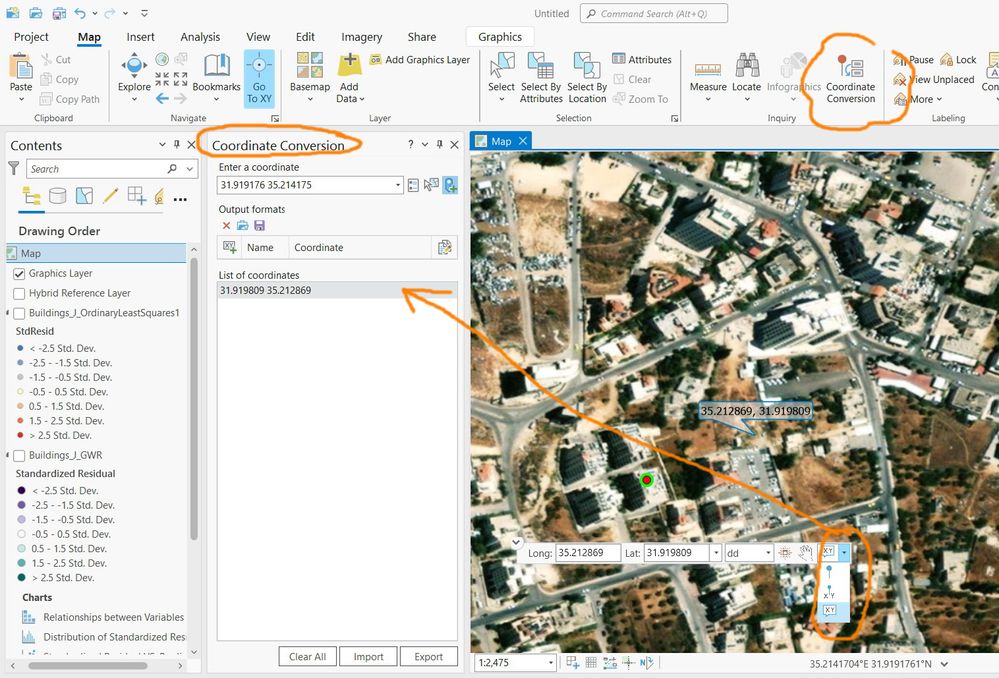

It would be great if the Pro is enhanced to have a tool to plot xy by clicking on the map
Currently, the xy can be plotted if only searched by the “go to xy” and “locate” tools

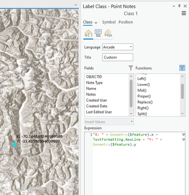

You could set up a label expression to display the X,Y of points you drop on the map.
Quick sample:
"X: " + Geometry($feature).x + TextFormatting.NewLine + "Y: " + Geometry($feature).y

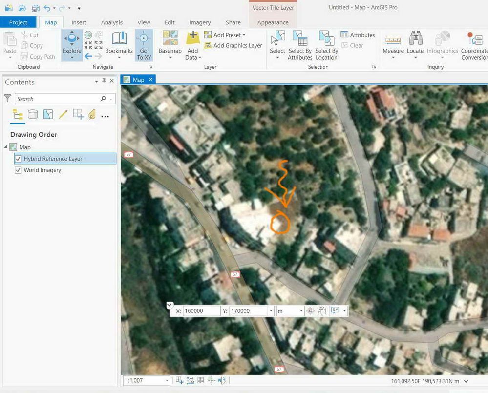

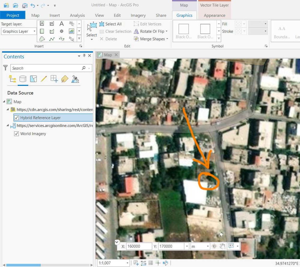

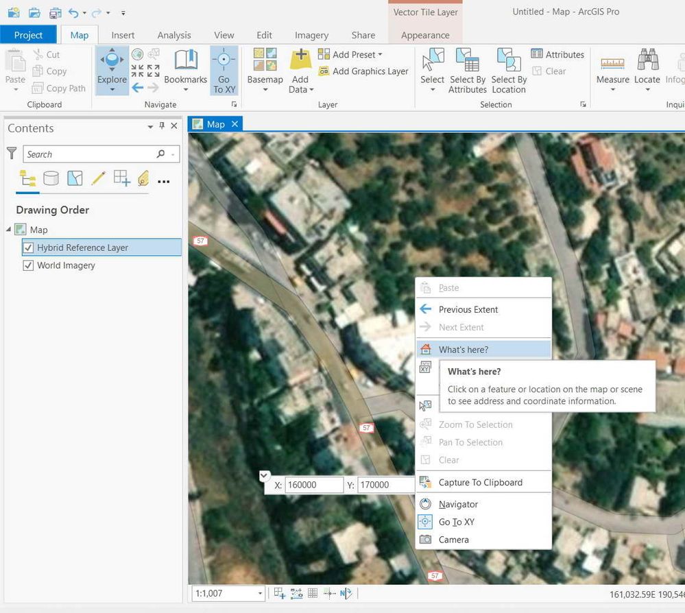

I’m not referring here to labeling an existing xy points. What I wanted here is just to click in the map to get the xy displayed (you don’t have a feature class that contains point)
For example, can you click on the marked location in the screenshot below to get its xy coordinates displayed?
KoryKramer

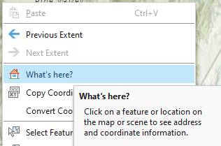

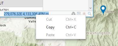

You can right-click > What's Here
and get the coordinate information at that point in a popup. The coordinates can also be copied
The limitation is that this supports one point at a time. Can you describe your workflow? Do you need to click on multiple points to display their coordinates temporarily on the map? Do you need to do anything with those coordinates afterwards (like paste them into another system)? What are the display coordinates used for?

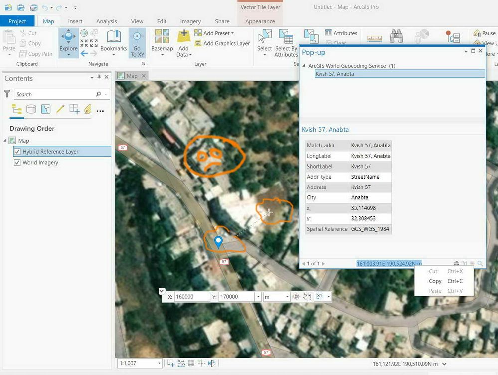

JamalNUMAN
Actually, three limitations
  • The point identified is not labeled with its xy coordinates
  • Multiple points can’t be identified
  • Two symbols are displayed
