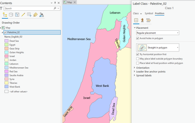

Mediterranean sea and Gaza Strip could use that 'curved in polygon' that Marco demonstrates in his screen grab

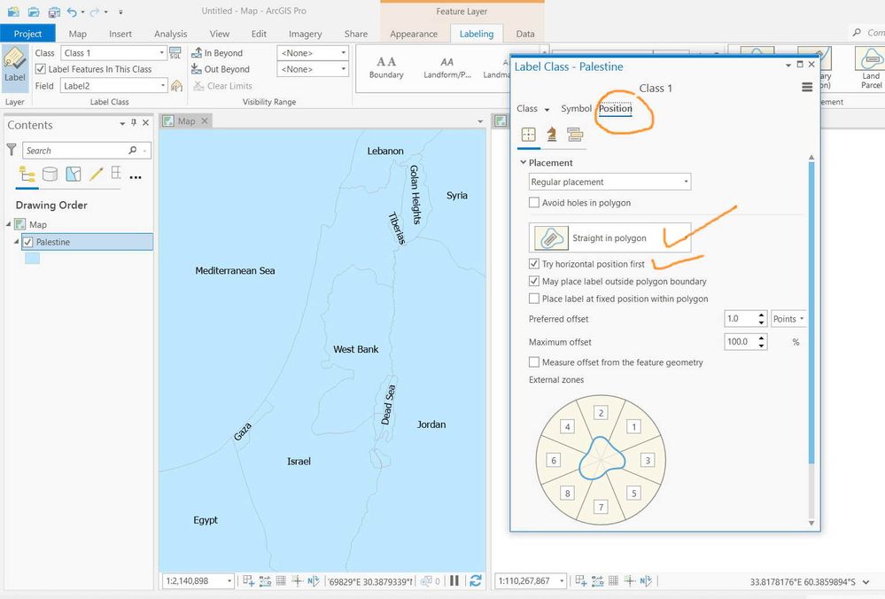

Hi @JamalNUMAN
the best way to do this is to use the Straight in polygon option combined with the Try horizontal position first.  remember to take off the stacking.  For labels like the Sea you can put that in it's own label class and then start to experiment with curved labels
