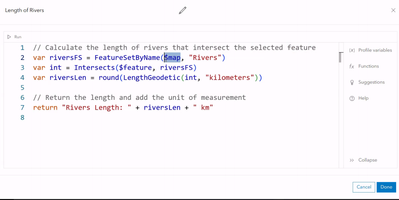

When exploring data one option is to use Python under Python Window. But if one wants to explore the data via Arcade it's not possible in Pro. It would be nice to have something similar to Python Window or Playground on the Dev site for Arcade in Pro.
Maybe adding an editor  to Pro similar to the one available in Map Viewer or Dashboards would be nice.
