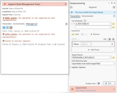

ArcGIS Pro 3.2.1; Oracle Express 18c; the database is not a geodatabase (no ArcGIS Server or Enterprise)
I have a testing environment where I use an Oracle XE database to test issues in the latest version of Pro before reporting ArcGIS bugs and submitting ideas.
In that environment, I’m not able to edit data, because editing is only supported in FCs that are registered with a geodatabase: Unable to edit a feature class not registered with the geodatabase. I suppose that is expected.
I am able to create/edit data in a separate data source, such as a shapefile or mobile/file geodatabase, and then copy/paste the FC into the enterprise database using Catalog.
That works, but it would be helpful to have an additional option: Append external data into a FC in the enterprise database to avoid recreating the FC. Currently, the Load [Append] Catalog context-menu option is not available for enterprise database FCs. And the Append GP tool throws an error: "ERROR 160236: The operation is not supported by this implementation."

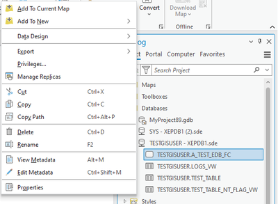

Also, in your environment, does Catalog have the Load context-menu option for FCs in a non-GDB Oracle database? Here's a screenshot of my environment where the Load button is missing: https://i.stack.imgur.com/geKH5.png

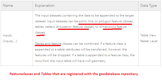

Append (Data Management)—ArcGIS Pro | Documentation
Featureclass is in fact a table with a spatial column and an ObjectID (unique identifier) that is registered with the Geodatabase Repository.
Table in the documentation is referring to a database table with attribute fields, no spatial column, and the table is also registered with the Geodatabase Repository.
MarceloMarques
Note: a Featureclass is only a Featureclass when it is registered with the Enterprise Geodatabase, otherwise it is just a table with a spatial column. You will not be able to edit the Non-GDB table in ArcGIS Pro, you can only edit the table with spatial data with ArcGIS Pro after it is registered with the Geodatabase Repository, and it becomes a Geodatabase Featureclass.
