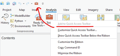

I am sure that our geoprocessing team will take a look at this. In the meantime, can I offer a couple of thoughts to help you be even lazier? (because personally hitting Alt and then A and then TS sounds absolutely excruciating to me).
1. Add the Tools command to the Quick Access Toolbar.
Then hit Alt and the number (6 in my example):
So we've just saved a couple of clicks to aid in your laziness (ahem, increase your productivity!)
