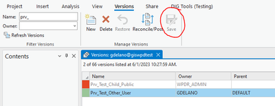

  1. User1 creates a parent version and sets it to Private.
  2. User1 creates a child version off the parent version and sets it to Public/Protected.
  3. User2 opens the Versions view in ArcGIS Pro. They do not see the parent version (expected behavior). They see the child version, and a red square with the hover text, "A parent version is required", appears next to the public/protected child version. The Parent field is blank since the parent version is private.
  4. User2 creates a new version, deletes a version, or renames a version. The changes are unable to be submitted because the 'Save' button is greyed out. This is due to the red square error described in #3.
  5. User1 changes the parent version from Private to Protected. User2 is now able to manage versions and save changes.
Parent version owner sees (User1, WPDR_ADMIN in image):
Other users see (User2, GDELANO in image):
Other user (User2, GDELANO) tries to create a new version:

User2 is pointing to a different parent version (DEFAULT in the images), and does not need to interact with the private parent version created by User1.
Our department uses a mix of A, B, and C in the image below (taken from the Versioning 101 article). In the scenario I described, User1 would be using C: 3-Level version tree and User2 would be using B: 2-Level Version Tree
In our environment, the users that own parent versions are responsible for reconciling/posting the child versions and we have a nightly script that reconciles/posts the parent versions up to DEFAULT. Versions that are made directly off of DEFAULT get manually reconciled/posted. This process is not affected by the issue described above.
The main issue is that users are blocked from making any changes to versions if there is a public child version and a private parent version that they can't see (owned by another user). In addition to making new versions, User2 is blocked from deleting any versions they own or even just renaming versions. No changes can be committed until the "red square" is resolved.
