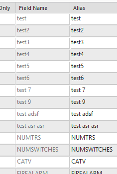

At the end of the day, it would be useful to be able to define the alias AS THE USER SEES IT IN GIS APPS such as in the image below in the view itself and have it saved in the database so that you don't have to enter those aliases over and over and over every time you use it.
Sure, you can create a project and share it among people so they can copy and paste their alias settings into the new project, but that's a hack and it would be nice to have it clean... just set it once and you're good.
