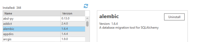

ShaunWalbridge
I agree most users would prefer to avoid the command line. For the non-default packages, they can be removed by clicking the Uninstall button in the backstage:
For the specific feature requested in this idea, I think that suffices. If there are other concerns or needs, we can address them in separate ideas or issues.
