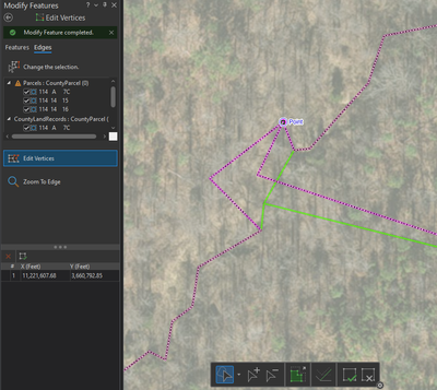

What I am specifically referring to how you can ONLY edit edges OR nodes separately, but not at the same. When selecting a topology edge, the vertices appear as so:

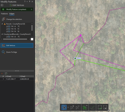

And when selecting a node, only the node is editable:

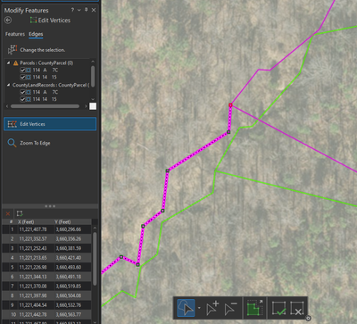

In the following example, you can see that if I were to simply move this edge to the desired snapping point, my edges (and thus polygons) would overlap and result in typology errors and a general mess:
ChrisWozniak_3-1707341440401.pngChrisWozniak_3-1707341440401.pngChrisWozniak_4-1707341455414.pngChrisWozniak_4-1707341455414.png
Being able to edit\delete those adjacent vertices would allow me quickly make the edit, without being forced to cancel my operation and sit through rebuilding topology over and over again.

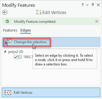

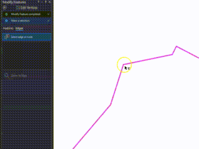

  3. Are you clicking "Change the selection" (see image below) or are you doing something else to get to the point where you can select vertices and move them after moving a node? The other way would be to move the node > click somewhere on the empty space (this changes the tool back to active select) > click on the edge where you want to move vertices > move the vertices.

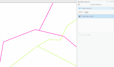

It might be helpful to see a video your current workflow (if that's possible). Or I've made a GIF of what I see when I attempt what you describe. Note that I don't have to cancel anything or wait for the topology graph to build. Please compare what you see to what I show in the GIF below. Perhaps there is a performance issue that you see?
Thanks for any clarification!
-Scott

Your workflow and video are showing the edits in order of first moving the node, and then moving the connected edge vertices. In certain situations, like above in my example above, this isn't ideal and results in a topology mess which takes longer to clean up. So I am kind of forced to clear the way by deleting the nearest vertices on connected edges to prevent overlapping edges:
It would be very nice to simply be able to have access to edit those connected edge's vertices without having to change the selection (and thus sit through rebuilding topology). This way the workflow would change to: select node, both the node and vertices of edges affiliated with the node become available to edit, delete the in-the-way vertices (or otherwise modify them however needed), move node, finish. This would save tons of extra clicks and topology building down-time.
