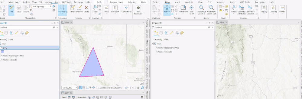

Please add the ability to drag and drop layers between projects.  This is a feature of ArcGIS Desktop.  It is very helpful in a high volume/short time line environment.
4 Comments
AlfredBaldenweck
You can already do this
That being said, there is a need for being able to drag things like layouts or maps to projects that don't already have a layout/map in them. If that's what you mean, I'd upvote it.

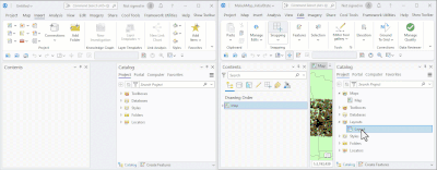

As @AlfredBaldenweck pointed out this is already possible.
It is also already possible to drag/drop maps/layouts into other projects that don't already have those:

KoryKramer
Been in there a long time. Note that the drop target is important. You can't drop a map from one project onto the map of another project (i.e. you can't add a map to a map). You drop it into the catalog.
