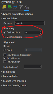

DavidOutrata
It is hidden under Advanced symbology options:
JoyDRoberts
@DavidOutrata - That might fix the issue for some users, but doesn't resolve the underlying data issue as posted by Ava and myself.
Thanks for posting it.
AvaFarouche
Yes, @DavidOutrata , as I indicated in my original post, I found the way to fix it in the Advanced Symbology. However, the problem remains: I have to fix it there for every attribute, for every layer, which means, as I indicated in my original post, I had to change it NINE HUNDRED TIMES. This does not address the problem. Thanks.
