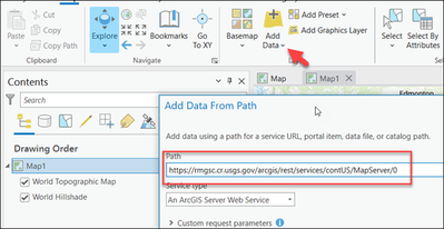

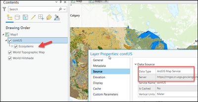

hi @Nathan_A_Wood
Even though, the Catalog pane does not list raster layers when you drill into a map service, but you can use Add Data from Path command and paste the url pointing to the raster layer off a map service and you will add a map service layer (aka map image layer) containing just one layer in it.
please let me know if it doesn't work for you or you have any suggestions.
Thanks
