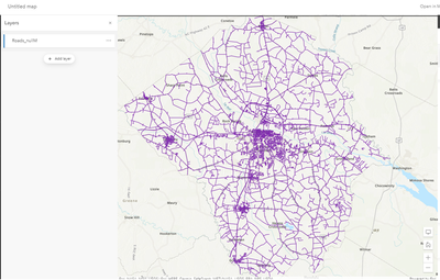

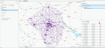

I do not see this occurring in the current software.
Pro:
Shared to ArcGIS Online:
