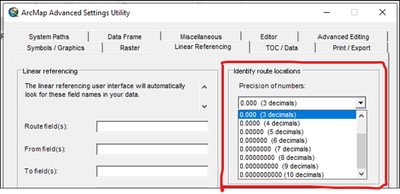

When I click on an M-enabled line feature with the Explore tool, the M-value is displayed at the bottom of the Pop-up. But it only displays up to 2 decimal places. I need to see higher precision M-values. Please enable the user to adjust the number of decimal places displayed for the M-value in the Explore Pop-up.
This capability was available in ArcMap, for the Identify Route Locations tool, with the ArcMap Advanced Settings Utility. Please bring it back for Pro (or direct me to this setting if it does exist).

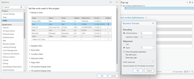

Thank you for submitting this idea! There is currently a way to change the number of decimal places/precision of the M-values you see at the bottom of the pop-up by following these steps:
  1. In ArcGIS Pro, go to Project > Options > Units.
  2. Click on the Format field for your desired unit.
  3. A Numeric Format window should appear, allowing you to change the number of decimal places.
  4. Once you have done this, open the pop-up for your M-enabled line feature and you should see the increased precision in the M-value.
Please feel free to reach out if you have any further questions about the precision for M-values!

When you adjust the number format of the default unit (no matter whether it is ft, m, km, mi, etc.), it also applies the change to the precision of the M-value produced at the bottom of the pop-up as shown in the image above. Unfortunately, I do not believe there is currently a way to adjust the M-value precision independently of the precision of the default unit associated with a project.
