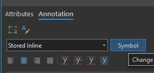

Individual annotations in a class can be updated in the ArcPro UI using the Symbol button in the annotation attributes:

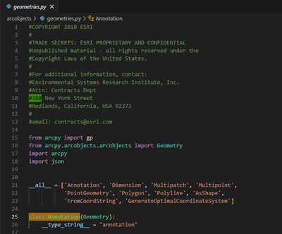

Since this is essentially just updating that stored CIM definition, why couldn't this be more transparently exposed to arcpy? The encoding of the data in that bytearray/memoryview object is opaque and seems to have leading and trailing bytes that differ based on annotation type, but it wouldn't be difficult for a developer that knows the spec to write a few classes (e.g. arcpy.Annotation) that handle that gracefully. There seems to be a stub type for Annotation in the arcobjects.geometries module:
So why hasn't this been implemented yet?

We implemented an approach for annotation in arcpy.da cursors in ArcGIS Pro 3.4 that uses an Annotation object tied with arcpy CIM access to fully expose the annotation feature content. See https://pro.arcgis.com/en/pro-app/latest/arcpy/classes/annotation.htm for more details.
