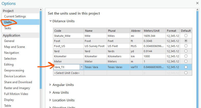

KoryKramer
Status changed to: Implemented
You can set units to Texas Varas in ArcGIS Pro.
Go to Options > Units and use <Select Unit Code> to add Vara_TX.
Learn more at Set traverse units.
