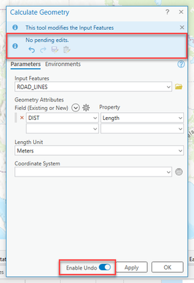

Please add the Enable Undo down button when doing a Calculate Geometry operation. Only the Calculate Field has that option.

"Calculate Geometry does not have an undo toggle and will not be listed in the save edits operation when running in an edit session"
MargaretCrawford
Status changed to: Implemented
This is implemented in ArcGIS Pro 3.4. The Calculate Geometry Attributes tool has an enable undo button. FYI, this feature has also been added to custom script and model tools.

Hello @ChristophKoschmieder , to answer some of your questions and concerns....
 Does this mean the undo / redo toggle button should now be visible for all custom tools in ArcGIS Pro 3.4, too?
No, the undo toggle is for tools that are in the new .atbx file format. So, you may need to update your tool, this can be as easy as a copy-paste from a tbx to an atbx. Then within the General tab of the Tool Properties dialog box, you can add the enable undo toggle in the Attribute options.
In order to use enable undo, the script's execution code must be set up correctly:
  • if the script is using arcpy.da cursors to perform edits/updates/inserts/deletes on a dataset, the script will need to use arcpy.da.Editor and set the dataset workspace as the workspace argument for the Editor. Before making the edits, use the editor.startEditing(with_undo=True).
  • if the script is using geoprocessing tools to perform edits (such as Delete Features, Append, Calculate Field, or others), no execution code changes are needed.
Also some things to keep in mind:
  • If Pro editing is disabled you cannot use undo. Editing and undo also require an open map.
  • When the tool finishes running, the edit will be logged to the Pro undo list and the changes can be saved or discarded using the Edit ribbon tab buttons, or the banner on the tool dialog.
  • The tool must have a derived output parameter set with dependency on the input parameter, to indicate that the input is updated by the tool code and should be locked during execution and refreshed when done. This is necessary to prevent someone from trying to edit a dataset in Pro at the same time that the dataset is being edited in the script, which would result in an error/lock.
