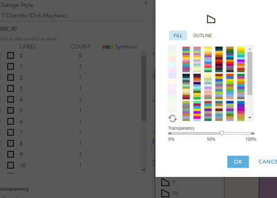

This is possible in ArcGIS Online. When you click Symbols and then adjust the transparency on the slider, it affects their transparency without overwriting the colors. Please bring this option to Pro.

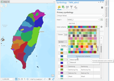

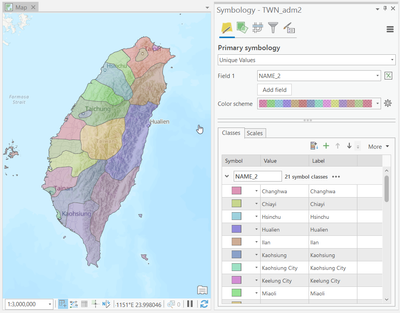

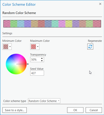

I see you are symbolizing polygons with unique values. There is a way to accomplish this workflow through ArcGIS Pro, through the color scheme settings.
In the Symbology pane, click the color scheme drop-down and click "Format color scheme..."
Then adjust the Transparency setting located here:
The transparency setting is applied to all features using the scheme.
I hope this helps!
