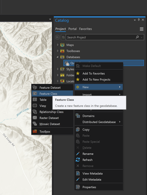

As a developer, I sometimes need to create a very small dataset for prototyping or proof-of-concept.  I want to put a few points/lines/polygons on a map.
The workflow I expect is something like:
  1. Create new map
  2. Click "Add Data"
  3. Click "New feature class"
  4. Fill in dialog box asking for filename, geometry type, etc.
  5. Add my points, lines, or polygons
  6. Save somewhere
  7. Back to my development work
The workflow I get is:
  1. Start without template (I don't need to save the project, just a feature class)
  2. Create new map
  3. Click "Add Data", because that's what I want to do
  4. Hmph, there's no way to create a new feature class
  5. Look for "Create new layer/feature class" button
  6. Ask the internet how to create a new layer/feature class
  7. Open the Catalog pane (had to search for that because the iconography isn't consistent)
  8. Expand the Databases item
  9. Right-click Default.gdb (wouldn't have thought to do that)
  10. Select 'New'
  11. Finally get the "Create new feature class" button that should have been under "Add Data"
  12. Add my points/lines/polygons
  13. Get back to development work, wishing that the UX for this was as easy as it is in QGIS where there's a prominent "New layer" button on the main toolbar.

@BillMitchell for the use case you've presented - "I want to put a few points/lines/polygons on a map." You can use Map notes:
Insert tab > add Point Map Notes gives you a quick point feature class for testing, Line Map notes, etc.
If you want points, lines and polygons all at once, use one of the other templates and they'll all be created at once.
Does that meet your needs?

@BillMitchell I like your suggestion and hope esri can make it happen. In the meantime, one suggestion I would make from one developer to another, is to create a new APRX project from a template that you would use (and continue to reuse) just for adding quick data (Project>New>Map), being sure to check the box "Create a new folder for this project".
What that gets you is a self contained work environment complete with a file geodatabase that is already set as the default fgdb for that project. From the "Catalog" pane, under the Project tab, your fgdb would be in "Databases". Right clicking on that fgdb allows you to create a new feature class in just a few seconds (actual time depends on the number of fields you add).
Once you finish the set-up wizard, it automatically adds the new feature class to your map. From there, clicking the "Edit" tab and the "Create" button allows you to start adding features to your map.
When you're done, you can either copy the feature class into your development environment or publish it onto a Portal, whatever your workflow requires. Once you've moved the data on, you can clean the fgdb out and have a clean workspace for your next project.
